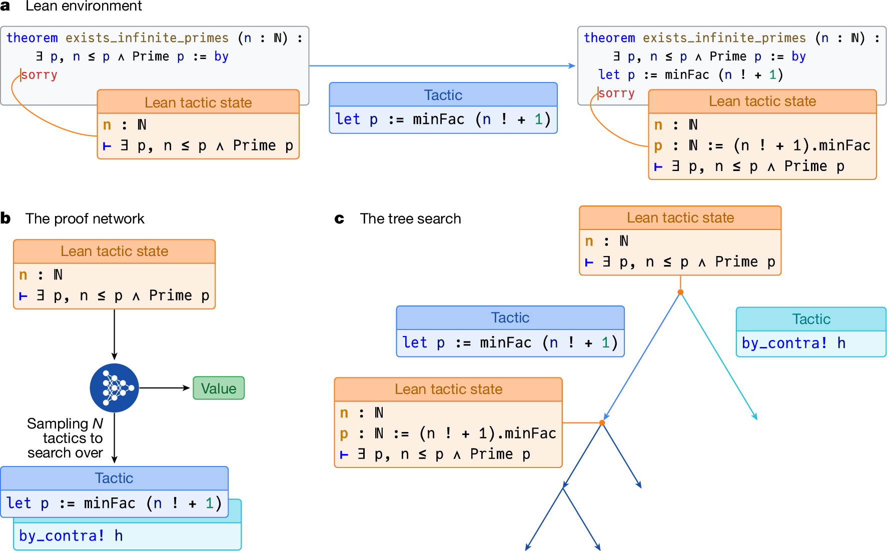

AlphaProof Nexus starts with a theorem or proof sketch written in Lean, a formal language in which every step can be checked by a computer. Gaps in the sketch are marked with sorry. Prover agents powered by Gemini 3.1 Pro propose edits, run the Lean compiler and use its error messages to try again. A result counts as a proof only when the file compiles with no sorry placeholders left.

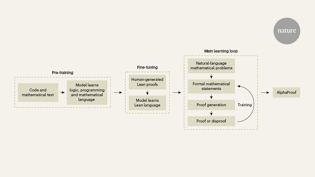

The full system adds Google's AlphaProof model, keeps a population of competing proof attempts and uses language-model raters with an Elo-style ranking system to decide which attempts deserve more work. That combination lets it explore multiple approaches while Lean acts as a strict filter on the final derivation.
